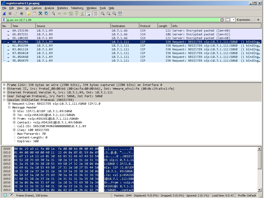

Протей упорно шлет:
<--- SIP read from UDP:10.7.1.89:5060 --->
REGISTER sip:10.7.1.111:5060 SIP/2.0
Via: SIP/2.0/UDP 10.7.1.89:5060
To: <sip:2652@10.7.1.111:5060>
From: <sip:2652@10.7.1.111:5060>
Contact: <sip:2652@10.7.1.89:5060>
Call-ID: 585CD32D6FDAC0000000010.7.1.89
CSeq: 100 REGISTER
Max-Forwards: 70
Content-Length: 0
Expires: 300
--- (10 headers 0 lines) ---
CSeq: 100 REGISTER
Max-Forwards: 70
Content-Length: 0
Expires: 300
В ответ тишина..
